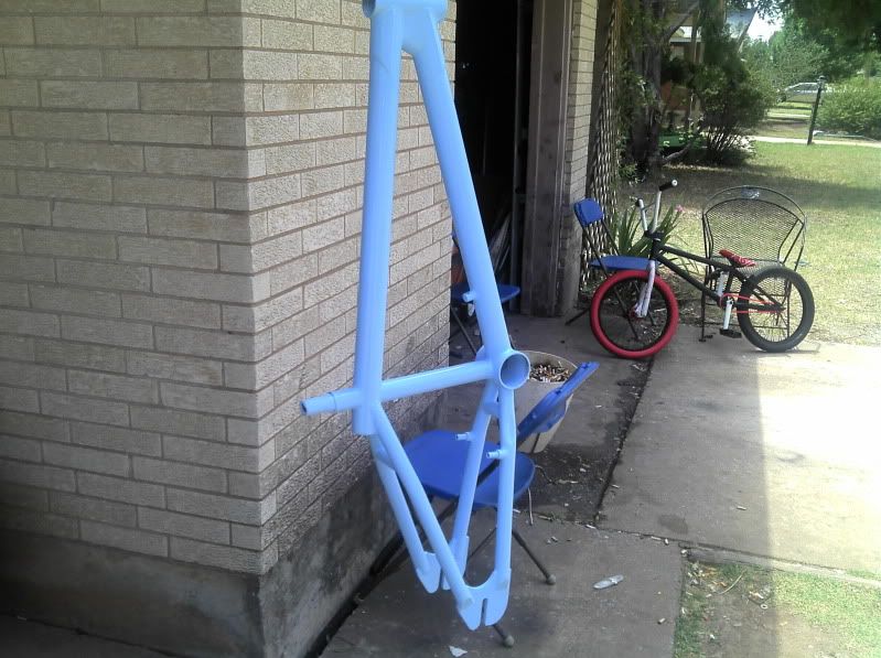

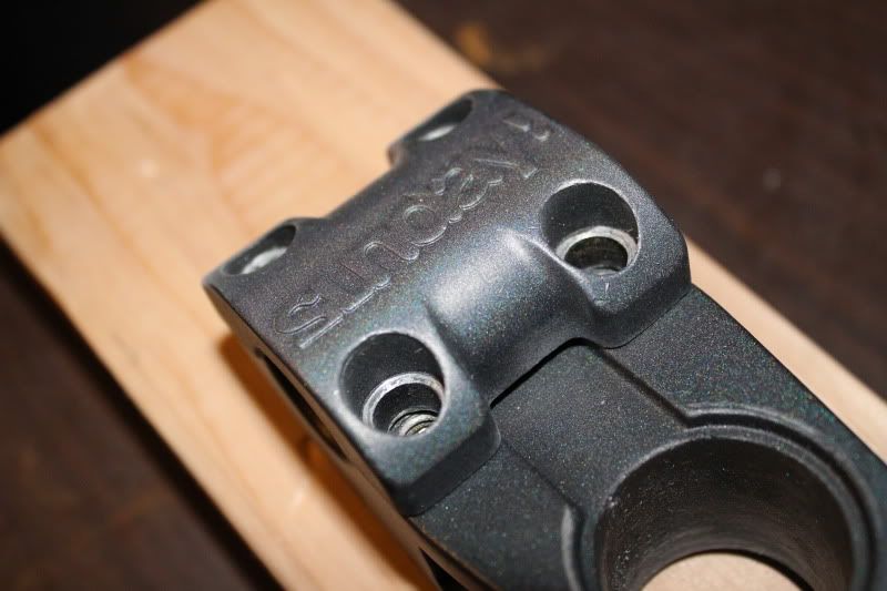

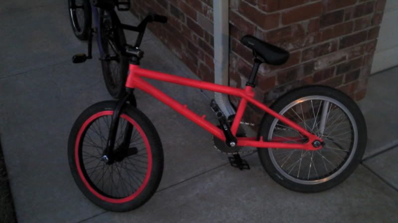

here's some shit i've done:
metal flake on a Sunday stem
i have some more on my old computer but honestly i don't feel like firing that piece of shit up, lol.
