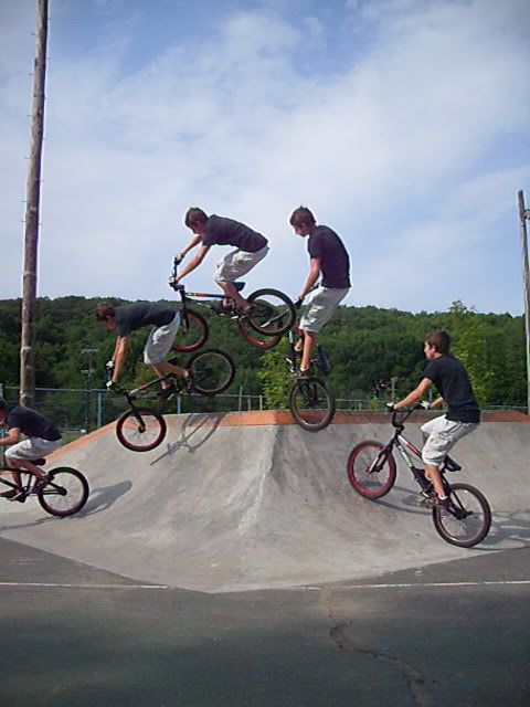

You have the image saved so take the cropped subject picture(the one you just fucking did!) and place it onto thevery first photo of the sequence. Do not open the file use the PLACE option. Remembering to put everything in a new layer, lower the opacity of the selected subject to around 30-50 percent this will allow you to line up the subject to the back ground nicely. Your screen will look like this while placing subject.
Image and video hosting by TinyPic
I left it slightly out of place to show you what was happening you of course will want to get the subject perfectly into place with the background the key is lining up back ground with foreground perfectly.
If you have succeeded in coming this far simply repeat the steps until you come to your last one then save at high quality. It’s a simple repeating of steps.

jees dude this was like middle of summer!
This place is so fun!
Trinity Bikes Freestyle Team! Bike Check Nigga!
12/10/2009 10:55 PM
Magical forks frame 3!!! where did they go?
and my face on frame 4 is like "boom forks are back!!"

12/10/2009 11:08 PM
StreetSkeet wrote: hahaha. I still love you.
fixed it
