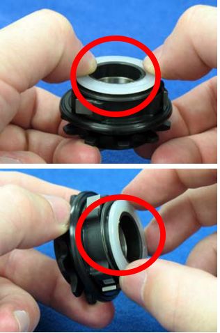

so just got a gsport ratchet, laced it all up, just put a "new" driver in it, old one was missing parts. and it feels like a rough pedaling compared to my primo mix that ive had for years. anyone else have some insight on this? i know my shadow interlock v2 chain rubs a little bit but not alot.

Are you sure youve installed it right?

yeah, its a 1pc driver, so its kinda hard to mess up.

I mean the plastic washer and circlip and all that shit

you talking the plastic washer that goes next to the bearing, its there. everything lines up

correction. just looked on the gsport manual, im missing the white washer that connects to the driver.

The bash washer is only in the older ratchets I think

There is supposed to be a plastic bash washer in the drive side cone for the 9t. It keeps the driver in place. Other wise the driver comes out of the shell and shit

this is definitely the thing im missing.
